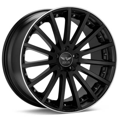

Sneaktip Posted February 9, 2013 Report Share Posted February 9, 2013 Have you found a setup you like for 22" with a 35 series tire? I am looking at purchasing http://www.tirerack.com/images/wheels/avarus/swap/avarus_av6_b_ci3_l.jpg for my 13 SHO and would like to run a 35 instead of the recommended 255/30/22. Quote Link to comment Share on other sites More sharing options...
